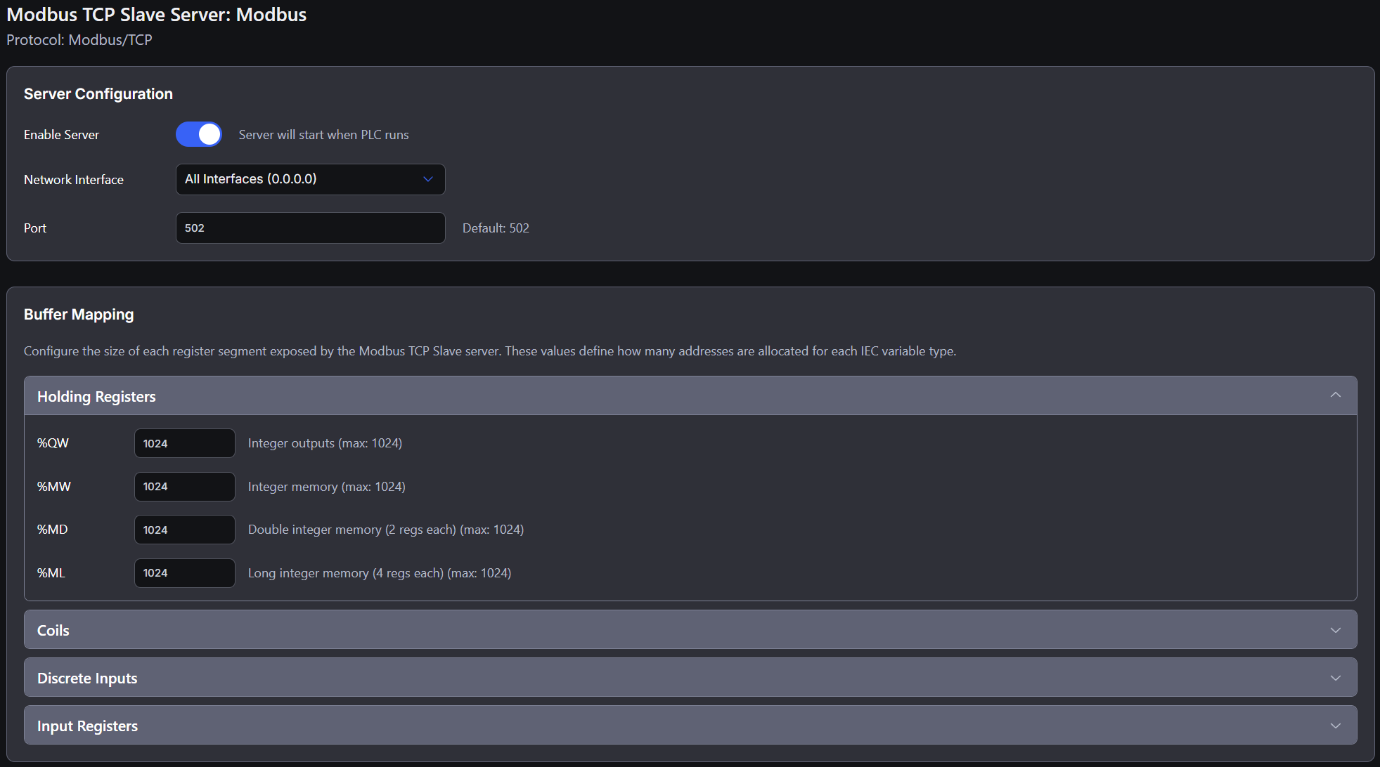

To connect to OpenPLC, first ensure that you have enabled the Modbus server in your OpenPLC project.

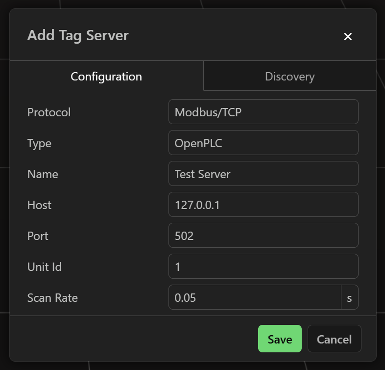

In ProtoTwin, add a Tag Server, select Modbus/TCP as the protocol and OpenPLC as the type.

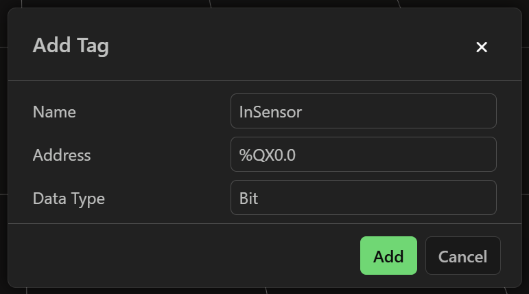

Once the tag server has been added, you can configure the tags that you want to read/write. Enter the address for the tag exactly as it is displayed in OpenPLC.
