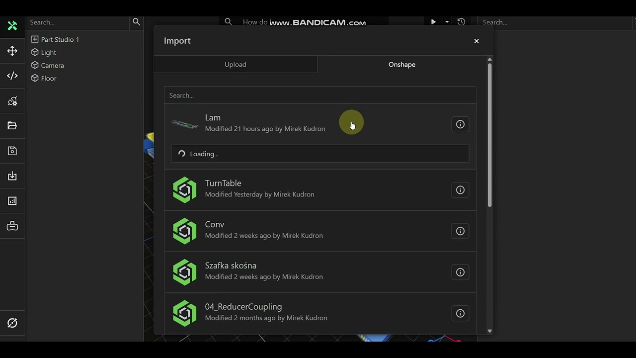

I checked that right after the fix you mentioned and it was OK but I tried to do it today and …

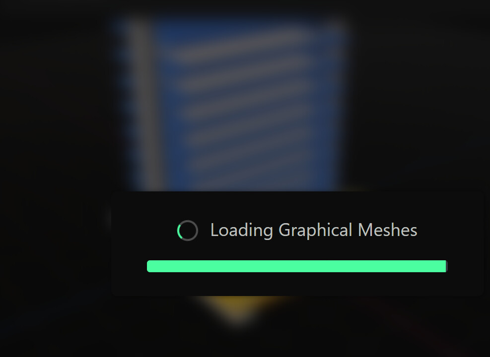

if there is a tag server configured OnshapeSync never finishes
I left it for over one hour and it’s stuck on this screen.
When I remove the tag server sync is done in just few seconds….

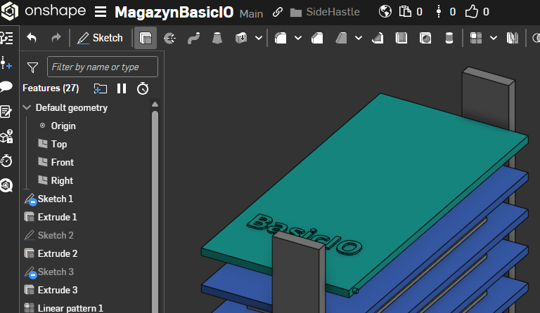

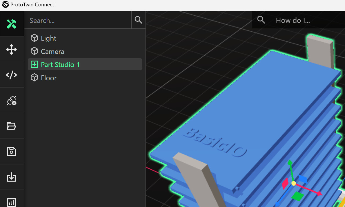

One more thing is that once model is imported, next sync updates geometry but not the color if something was changed in Onshape:
but in ProtoTwin green part is still blue

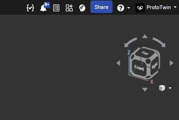

Additionally, I’ll need access to the CAD on Onshape. To do this, you need to open your Onshape document and click the share button in the top-right of Onshape.
Then enter contact@prototwin.com as the email to share the document with.

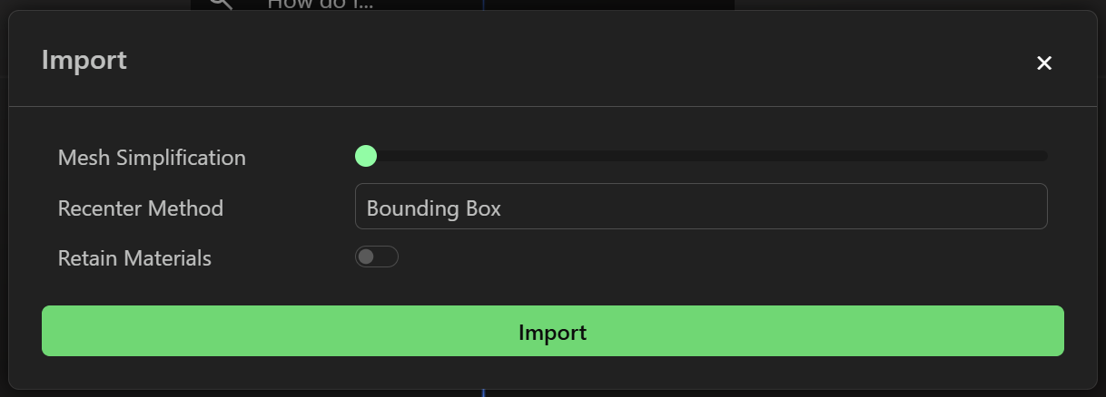

For the issue with the materials, can you try uncheck/disable the Retain Materials option when syncing. When Retain Materials is enabled, ProtoTwin will retain whatever materials are set in ProtoTwin, and ignore any material changes you made in Onshape.
Yes, “Retain Materials” did the trick.
