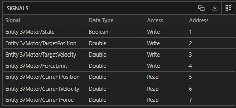

I’m having trouble reading values from Prototwin Connect. I can write (.set) values to the model no problem! however if I include any “.get” commands in my python program, the program will seemingly timeout and quit after 5 seconds. Here is the simple program being tested:

simulation_time_address = 0
motor_pos_set = 2
